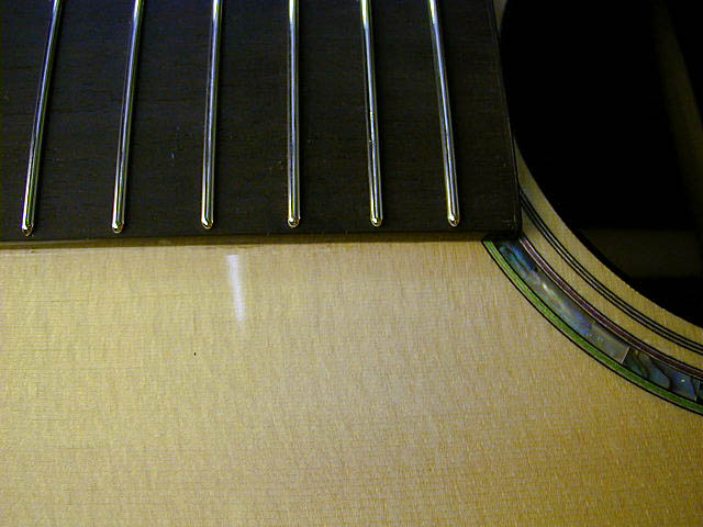

Stunning guitar. I like the fret ends, are they rounded or am I seeing it incorrectly? If rounded, did you do that with heat or abrading?
Steve, I did do the semi-hemispherical fret treatment (Google Harry Fleishmann (sp?) or True North Guitars). I did it differently than others, though, since I am not patient enough to do that by hand ON the fingerboard manually.
What I did is carefully cut the frets to length for each slot. Undercut the ends (StewMac Nipper) since my fingerboard is bound. Then, chucked up the fret (still straight) into my hand drill and brought it over to the belt sander for a quick sweep from about nearly perpendicular to the platen to nearly 0 degrees to it. Then just spin the fret against some finer grades of sandpaper backed against something giving like foam. Finally polish the whole fret on a wheel with rouge and install.
To do the semi-hemi on each fret takes about 60 seconds probably, so I don't think it's nearly as tedious as the more standard way of doing the semi-hemi after hammering them in.
That said, I will not be doing semi-hemi again, unless when I'm selling selling guitars a customer requests it. Here's why:
1) As sharp as they look, I don't really like the feel. It's minor, but noticable. I was warned about this by a well known luthier, but I tried it anyway.
2) Also, doing it my way (and also the standard way?) the ends don't go to the ends of the fingerboard completely - they're about 1/64" or 1/32" short, meaning I lost 1/16" of spread on the stings.
3) Related to #2, another thing is that it's real hard to place the frets accurately, since you have to hammer them in with that small amount of space between the fret end and fingerboard edge, and make the space the same on both sides. The ends (sighting down the fingerboard) end up staggered pretty ugly! Plus, despite my careful measuring the pre-cut fret, the fret lengths didn't come out accurately enough since I foolishly didn't use the actual fingerboard as a guide. Doing it the standard way (installing first, then cutting to length) eliminates this problem.
After posting the "official and real" debut photos of this guitar next week, I'll also post photos of some of the problems I encountered (like I described above), in the hopes I may save someone the trouble of having to learn themselves.
PostPosted: Fri Sep 08, 2006 3:20 am
Posts: 183
I just realized I have a better photo of the fret ends with me. If you look closely, you can see the unevenness of the ends even in this shot.
